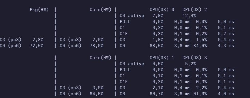

I have attached coreboot and kernel logs. It seems like the CPU does enter some C states but it doesn't enter C7. There is a screenshot of powertop idle stats tab attached.

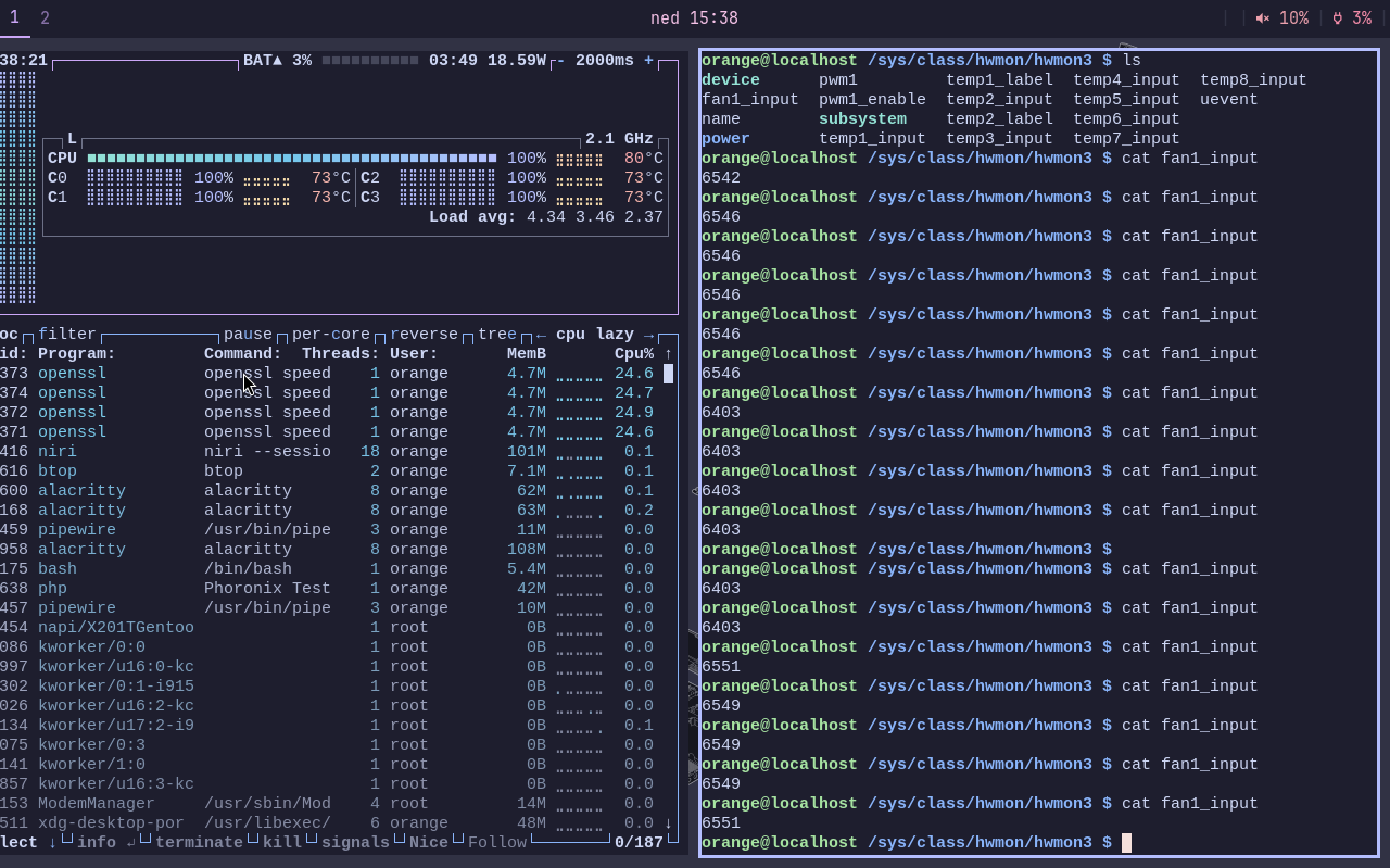

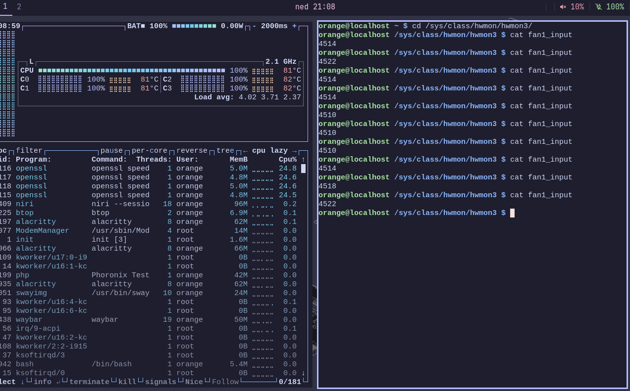

I have been using coreboot on the laptop again for a few months, but because of the fan noise and worse performance, I had to flash OEM BIOS again. Today I ran the same benchmark with both coreboot and OEM BIOS with turbo boost disabled, and the benchmark score was the same, but with coreboot, cores were around 7°C colder than the whole package, while with the OEM BIOS, package and cores were usually at the same temperature. Package temperature was the same, but with coreboot fan had to run around 1900 RPM faster to keep the same package temperature as the OEM BIOS, which probably means that with coreboot CPU or something else in the package is generating more heat while doing the same work. I have attached two screenshots that were taken in the middle of the benchmark with coreboot and OEM BIOS.
