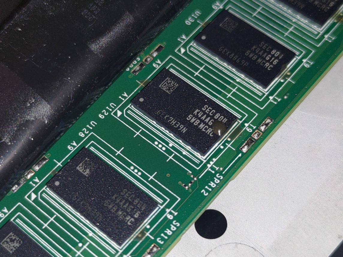

X280 (20KE-S2EW08) flashed with main coreboot (git clone a few hours ago). Only shows 4GB of RAM when it's actually a 16GB model.

According to the log it detects 2x "K4AAG165WB-MCRC". Maybe the capacity in the SPD file is incorrect? I don't see SPD files checked into the mainboard dir, so I cannot verify.
LE Updated by Ladislav Ezr 9 months ago Actions #2
Patrick Rudolph wrote in #note-1:
It actually chooses the correct SPD file. I have used the SPD file provided by coreboot (spd/ddr4/set-0/spd-9.hex). This file is not specified in the memory Makefile.mk of the X280.

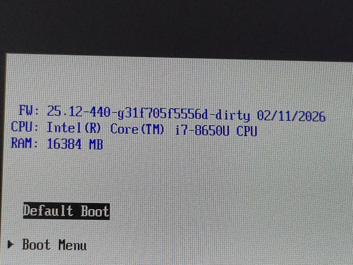

Fixed by applying https://review.coreboot.org/c/coreboot/+/91170
Please mark as closed.
