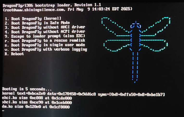

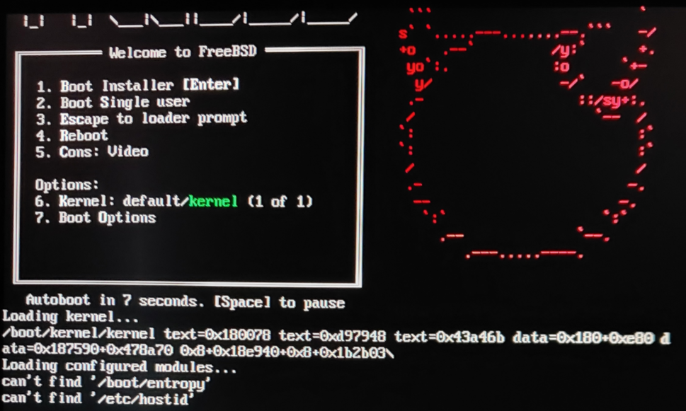

hello there, i installed version version 25.06 on this computer and Linux seems to boot fine with grub but BSD seems to have issues booting, i have tried FreeBSD and DragonFlyBSD(mainly) with little hope of getting past the initial boot screens. seems to boot the loader properly but seems to freeze when loading the kernel or some module, not sure.
below are the images for the error, but i also have transcripts too:
Autoboot in 7 seconds. [Space] to pause
Loading kernel...
/boot/kernel/kernel text=0x180078 text=0xd97948 text=0x43a46b data=0x180+0xe80 d
ata=0x187590+0xf87a0 db=0x18e940+0x1b2b03)
Loading configured modules...
can't find '/boot/entropy'
can't find '/etc/hostid'
Booting in 5 seconds...
kernel text=0xbca2e0 data=0x17845b0 bss=0x4d46c8 syms=[0x8+0xfa50+0x8+0xbe1b7]
ehci.ko size 0xbe2c0 at 0xdc1ee00
xhci.ko size 0xec90 at 0xdc2b0c0
dm.ko size 0x120e0 at 0xdc3bf00
I don't know what exactly is failing but it seems to freeze before showing any error on dragonfly at least. freebsd i dont really know, but i did manage to get it to boot on uboot once, not when i tried recently though, and dragonlybsd didnt with uboot.
CPU is the i7-7700HQ if that matters,
does not really seem to be USB related as i get the same errors booting directly off SATA too,
if you need any more info or anything let me know, i would absolutely love to get BSD's in general working on this setup.
i also have tried this on libreboot, which has the same results for me. if there is a patch, a backport to 25.06 would be nice so that libreboot's current version can have support too. thank you!

E7 Updated by eman 777 about 1 year ago Actions #1
mainly using SeaBIOS.
WS Updated by Walter Sonius 12 months ago ยท Edited Actions #2
eman 777 wrote in #note-1:
Using EDK2 (with libgfxinit framebuffer) instead of SeaBIOS with the "FreeBSD-14.3-RELEASE-amd64-mini-memstick.img" on the Dell Optiplex 5040 SFF (which boots Dell 3050 port code only a few edits to its memory init) continues to boot the FreeBSD installer fine to a ncurse looking installer.
My guess is that if you want to keep using SeaBIOS you may have to alter the "libgfxinit mode" from "framebuffer" to "text" or vice versa during compile of coreboot?
Update:
Also SeaBIOS 1.17 works using libgfxinit in text mode both with FreeBSD-14.3 and FreeBSD-16.0@20251110, but when using libgfxinit in framebuffer mode it gives the same can't find '/boot/entropy / /etc/hostid'. It does respond to keyboard input after that, so my guess is that only the video output is frozen/broken!
